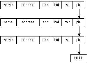

You can use pointers to structures to create linked lists. In these each item in the list holds a pointer to the next. This technique is sometimes used in preference to creating an array of structures, since with a linked list you only need to use as much storage as is required, rather than grabbing the maximum amount of space as with an array. On the right you can see how this would work. I have created a link list of customer items. The structure definition holds a pointer to customers as the last field in the structure.
Note how the last item in the list has its pointer set to NULL, so that my program can tell when it has reached the end of the list. I would have to have a pointer to the start of the list as well.
struct customer
	char name [NAME_LENGTH] ;
	char address [ADDR_LENGTH] ;
	int account ;
	int balance ;
	int overdraft ;
	struct customer * ptr ;
